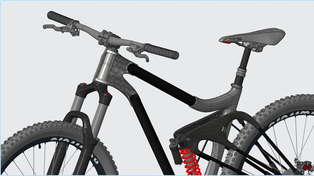

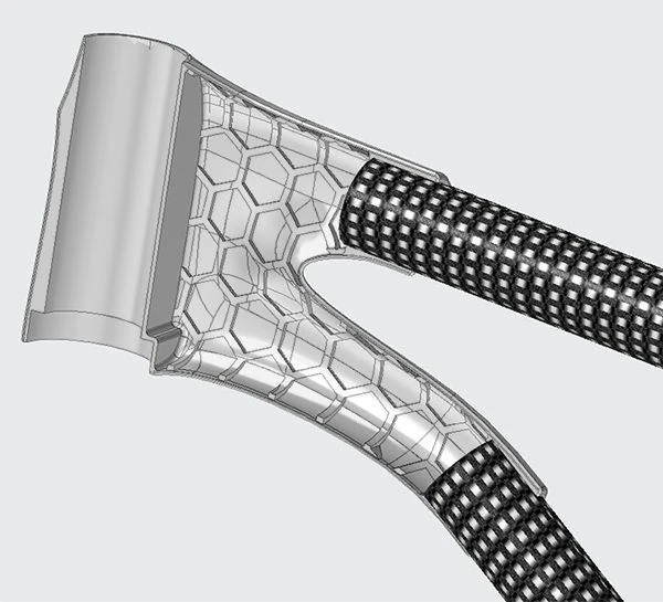

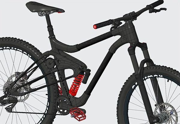

Ive done an extensive study comparing Freestyle wennpattern600.jpgwennbikes601.jpgwennbike1600.jpgSub'D to Catia and T-spines. I prefer Freestyle as well and if your interested I could make a comprehensive list
Not that we don't have  a few problems with the Creo version of Sub'd but ....

Nice bike! When are you guys going to offer video short corses for sale - as much as I'd love to come to Chicago and all 😀
