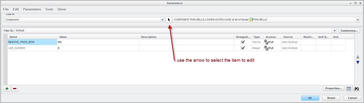

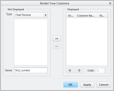

Being as these are component parameter, they don't show up in the model parameters list.
When you are defining the columns you want to see in the model tree, you pick feature parameter pull down, and then you have to type the component parameter name in the lower field and move it over to the Displayed column.
[cid:image014.png@01D01069.662DC330]
The tree config syntax looks like this:
COLUMN "Feat Params" "find_number" 10
COLUMN "Feat Params" "remove_from_BOM" 13

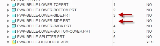

Last Friday I looked at writing a mapkey to create and show component parameters in the model tree.
There are a number of issue to be addressed if you want to do this via a mapkey. Ultimately I think we need a solution that is more robust than a mapkey will be.
Parameter User Interface Old vs New
