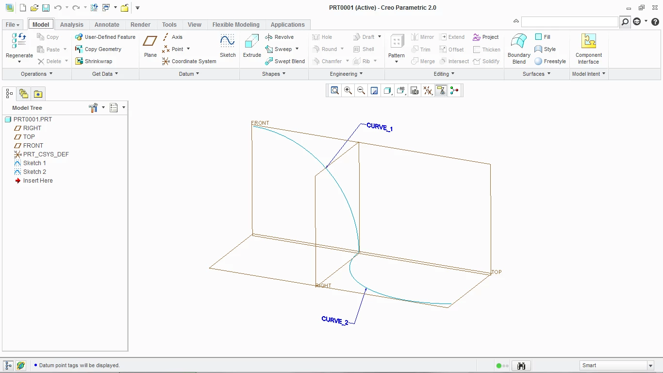

As shown in image, I want to join this two curve, which is drawn in two different plan.
So, now i want to join this two curve...
For this i cant found any command in creo..
in solidworks there is a command, named as COMPOSITE CURVE..
I am sure that this command is there in creo, bt i cant found it...

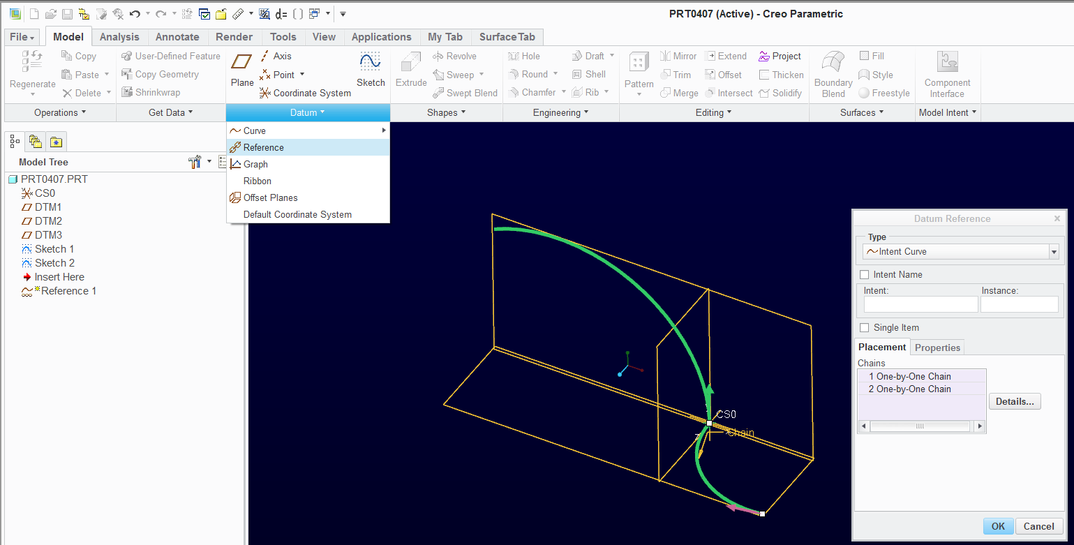

Best answer by nrollins
The trick is CTRL-C to copy the geometry and CTRL-V to paste it - this brings you to the composite curve feature. I don't know of another way to get there.

There may be another way to do this - what I will show you will seem very awkward and strange... But it works.
Attached is a video - quicker for me than typing. Please let me know if you have questions.
Video Link : 5062
Hope this helps!
-Nate
I am intrigued with the suggestion put out by Antonius and will try it out the next time I am able. It looks very promising and more stable and easier to create...
-Nate
June 24, 2014
Creo uses datum references to create intent curves. You select curves and make them into a single reference feature by doing this.
I know there use to be other methods, but this one is probably the current direction PTC is heading with this type of feature.

I was going to suggest setting the filter to "Geometry", selecting one curve, then doing a ctrl-c then ctrl-v to cut & paste, then use the "Details" to select either single entities, or go rule-based, etc.
Is there an advantage to using a reference feature as opposed to a copy?
June 24, 2014
It is a very easy way to pick references -and- modify references for subsequent features.
Greater use of this feature would help solve a lot of failures when references are deleted.
