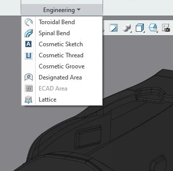

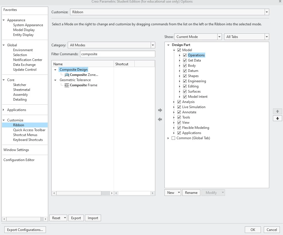

After installing Creo 10.0.0.0 Parametric with the UNI/Student license, the Composite feature is missing, as shown in the attached picture (It should be below "lattice". Other students using the same license and install configuration have it present. I reinstalled Creo, deleted and set up the license again. I tried configuring the ribbon (maybe the feature just isn't shown), but there is only a "composite properties" feature available with the name "composite" in it (see attached picture).

Not sure if this is at the heart of your issue, but in the commercial version of Creo, Composite Design was only put in starting in 10.0.1.0, as opposed to 10.0.0.0.
But if other students have it doing the same thing you did, then perhaps that's not at issue.
