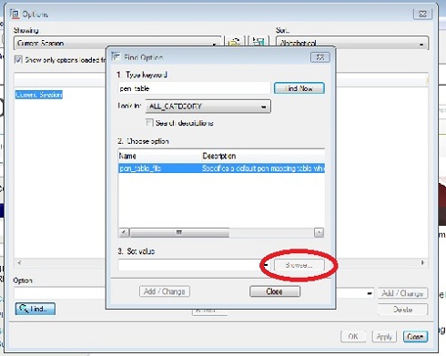

i am working in a pro/e WF3. i have a little problem in printing drawing file to pdf or plotter. i am having the pen settings for my plotter, and i cant ab
le to config my setting in config.pro. when i go to the tools>option>find>"Pen_table_file. the browse button is not working. as the image shown below. pls help........
March 26, 2012
Hi
You can write/edit your config.pro file manualy (use Notepad or Wordpad) and then you can use it.
Here is example:
open_window_maximized yes
orientation isometric
pen_table_file D:\applic\Configs\Wildfire3\pentable.pnt
provide_pick_message_always yes
proe_memory_buffer_size 200
pdf_use_pentable yes
Vladimir
