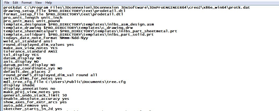

I am looking for 2 config options I was told that existed by multiple Creo/ Pro E instructors but they / myself were unable to find them.

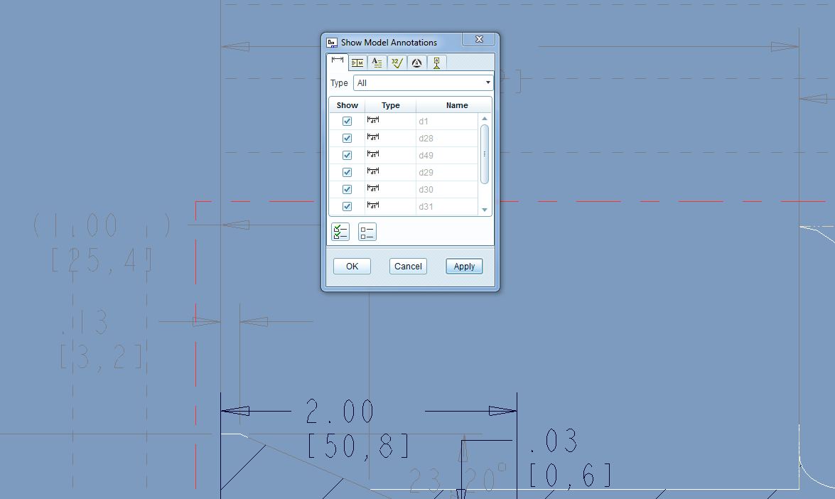

1) When I go into "show model annotations" everything is checked by default, I want it unchecked by default. Sometimes I get over excited with my centermouse button and select every dimension
2) When I start a new sketch by default the field is waaaaay out. ex. I start a like it is 300" long whereas I want something in the field of 3 inches.I was told there is a default scale config option.
Plus if anyone has helpful/ useful config suggestions I would love to hear them.

The first one should be
display_annotations no
!!!Determines whether or not annotations are displayed in 3D models.
!!!default yes
As for the second one i have not been able to find anything. The one suggestion I have seen a few times is to create a piece of geometry so that it zooms properly and then delete the geometry and save that part as the new start part. Or have a sketch in the start part with the dims you were looking for.
February 19, 2014
I already have that set to no.

I don't know if 1 is a config or version issue. When I select a view to show dimensions, for instance, the dialog starts all unchecked. This is Creo 2.0 default behavior as far as I know.

At work we just upgraded to Creo 2, from WF5 so I have both installed. Both default to checked
February 19, 2014
Odd, I just tested my default Creo 2.0 M040 behavior and my custom config behavior. Both the default config, and my config does not check any dimensions in either the model or the drawing. It highlights them all on the screen, but the checkboxes are empty.
When you load Creo 2.0, it creates a shortcut on your desktop that should have an empty config associated to it (if the install hasn't been changed). Could it be that your template files have this set in them?
As for 2... you could fix the size of your datum planes in your template file. This should limit the size of the extent. By default, datums have no extent fixed so they have to determine a bounding box. Once geometry is created, they have something to size themselves to.

#1 is show_preview_default and you want to set it to REMOVE which is now the default. PTC changed the functionality at either creo or WF5 to opposite what they used to use so you may have it opposite.
Steve
