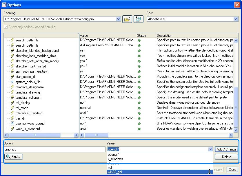

once I've opened the options where do I add the new configuration data?
October 8, 2011
Hi
The above image is a sample screenshot of configuration options
In the left side box (option) write the option and in the right side box choose/write the value
then press add and apply
add one by one all the options
