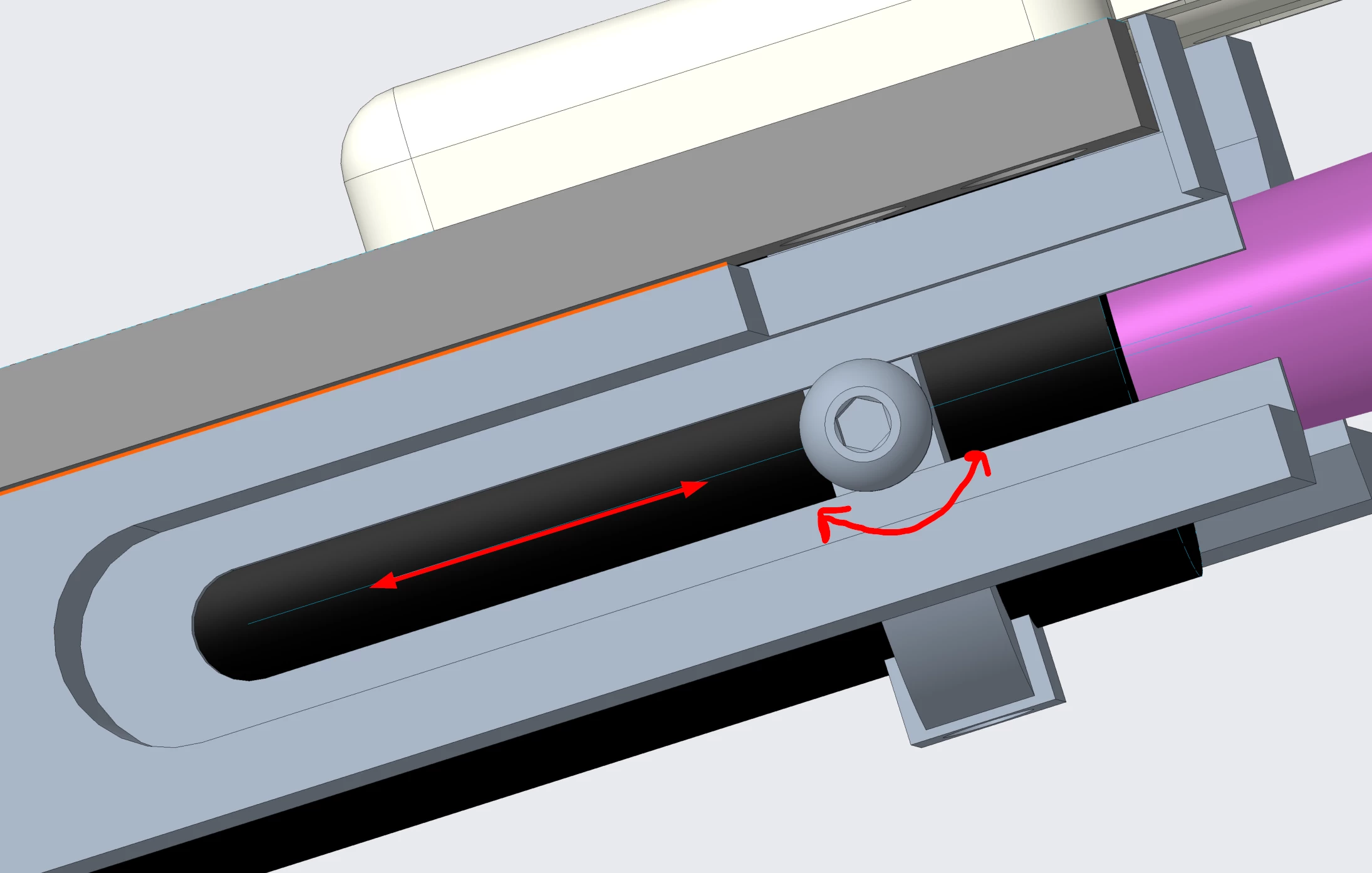

I wonder if you guys could help me out with this constraint in Creo Parametric 9. I designed this slot feature and I have this screw that I want to place there and have 2 degrees of freedom, one translation back and forward in the slot and another rotation around the screw axis.
What types of constraint should I use? I tried Pin and Cylinder but I could not make that work.
Thank you so much for the help!

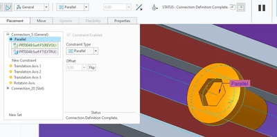

Thanks for your suggestion! I tried the slot connection, creating a point on the center of the screws head diameter and then I have set Point on Line to a straight line on the slot, however, when I move the part using the Drag command, the part moves around in all axis from the start to the end of that straight line.
I also tried something like the example, using a cylinder connection first to set the translation motion on the slot however when I add the slot connection I get the constraint is invalid.
kdirth
The exact assembly method will depend on how you need to connect it to other parts of the assembly.  You may need to add a New Set and use a general connection to control the screw orientation.
