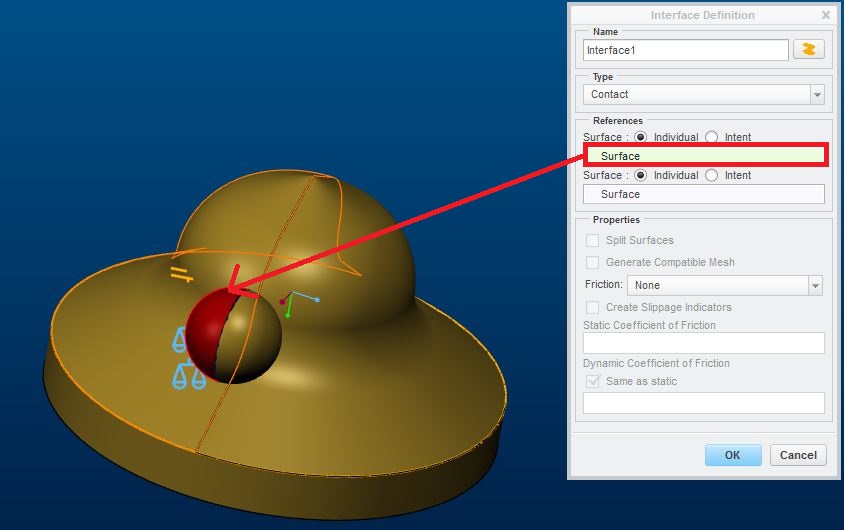

Good morning,
Time ago I created a contact interface kind surface-surface using intent surfaces, where one of the "intent surfaces" was a group of surfaces.
I'm trying ti repeat this operation but I'm not able to select more than one surface per contact surface.....doea anybody can help me?
Thanks a lot
Best answer by bmohapatra
See my attachment.

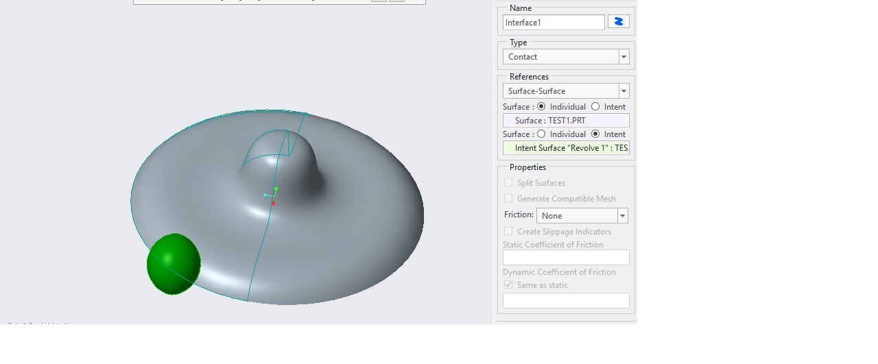

hi,
i know a workaround (example): bezier surfaces
regards
paul
ssambo1-VisitorAuthor
May 31, 2017
I'll to try to express better myself, I'm sorry I speak a poor english.
The exemple you chose sentences that the interface is between a two single surfaces:
surface number 1 and a surface number two, as follows:

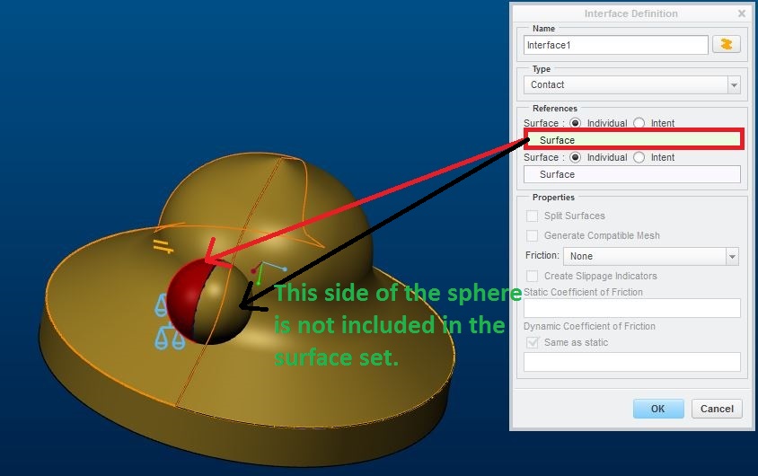

What shall I do, if I wanted that the surface number 1, for exemple,, was composed by the other side of the sphere, as indicated:
I don't know if I was clear enough

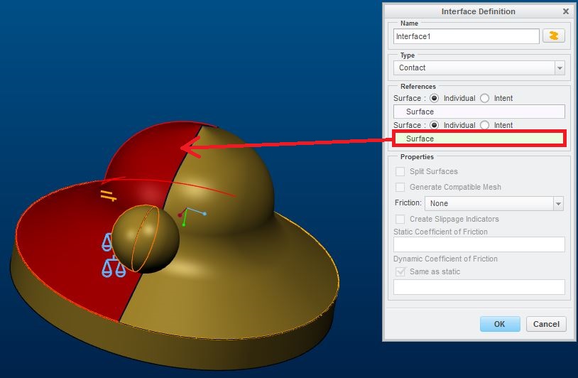

May 31, 2017
Im assuming u wud have figrd it out by now, I think its done like this
June 1, 2017
June 1, 2017
That's exactly what I was looking for. Thank you!
