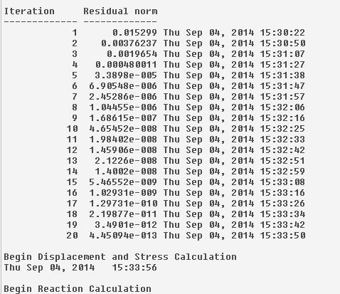

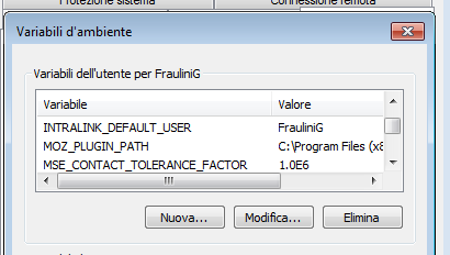

Hi all,
when you start a non linear analysis, the default tolerance at which each step the program tends, is 1e-14.
In WF5 you could modify this parameter inserting a windows environment variable called "MSE_CONTACT_TOLERANCE_FACTOR", as you can see at page 22 in the attached pdf.
This thing does not work with creo 2.
I don't find anything in the help.
Thanks.

Hi Giulio,
You may have done this, but did you restart the software after defining the variable?
Regards
Charles
gfraulini17-PeridotAuthor
September 5, 2014
Hi Charles,
yes I've restarted the software, the computer, all. If I use WF5 it works. Only with Creo 2 I've problems.

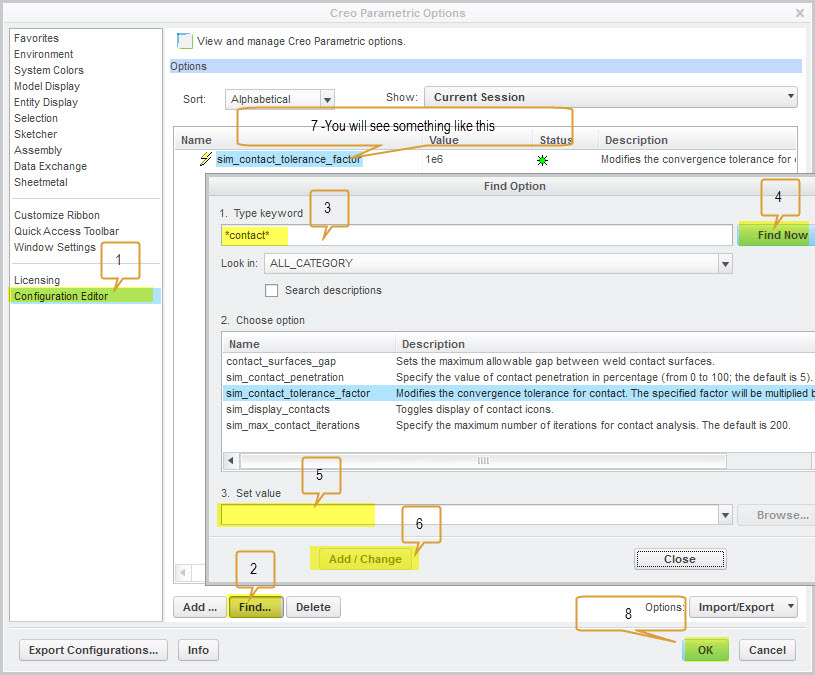

September 17, 2014
Hi Giulio,
You can try setting it from GUI: File->Options->Configuration Editor. See following pic for rest of the steps.
