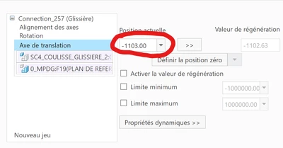

Hi community
Is it possible to drive constraint with parameter ?
In my example with slider :
I want to drive actual slider position (value in red circle) with parameter
it is possible ?
thanks
pausobAnswer
Jan 5, 2023 9:57 PM UTC

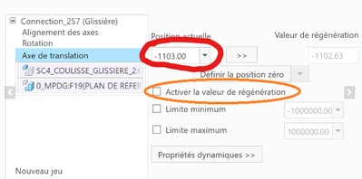

Typically, you would check the "enable regeneration value" box to turn the joint into a "driver" and make the dimension available for use in relations.

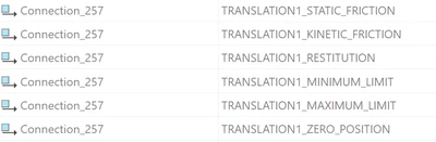

in parameter for slider, i find this
it will suffice that there is a parameter for the position, after with simply relation, mathcad can drive a slider
is it possible that there are hidden parameters that control the rest of the slider definition?

another option is to write same value in slider parameter
  • translation minimum limit
  • translation maximum limit
But is don't work
pausob19-TanzaniteAnswer
XDN14-AlexandriteAuthor
Jan 6, 2023 8:23 AM UTC
after check the box, i don't have a new parameter for slider 😥

second way
the pausob's solution
check "enable regeneration value" in slider definition
and click the the slider part in 3D window, now you see the value
after it, is simply to drive the value in relation windows with mathcad parameter following the usual method
Finally, i choice the first way !
the second way make probleme because is necessary to re-open the contrainst definition window to update 3D model
for first solution , i don't have this problem, the 3D model is directly right !
