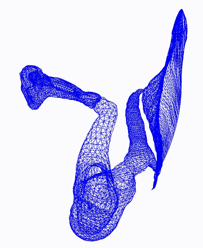

I've a 3D image in .igs which I'd like to convert in .prt in order to export its geometry and then modify its.
when I open in part model in Creo Parametric 2.0, i get a surface mesh but I'm not able to get anything of it !
Can anybody help me ?

Hello Arielle. Welcome to the forum.
Most IGES files are surfaces. It could also be that the file was actually a facet file. You cannot manipulate facet files but the Import Data Doctor can do limited modifications to surfaces. You can also act on surface "quilts" using Creo features.
It you simply need a 2D file in Creo, you have other options, such as making a drawing view and saving it as DXF.
If you can post an image of what you want to achieve, we might be able to help more specifically.

Hello, thank you for your answer.
In my case, I'd like to get a 3D file in Creo (a .prt preferably) and use the geometry surface to create a part and assign it a mass, etc.
I'm working on ossicles (human's mid ear).
My goal is to create an assembly and put joints between different part, and in final have a modelisation of the mechanic of the human' mid ear.
For now, I have this, and i also have each ossicle in a separate .igs.Sans+titre.jpg
November 28, 2013
When you go into the Import Data Doctor, does it say this is Facet geometry?
I have not found a way to edit facet geometry in Core Creo. This is similar to SCAN data from a 3D scanner. We have discussed this before on the forum.
If indeed they are surface quilts, you should be able to manipute them by cutting a hole in then and removing sections of it. Once a volume is enclosed, you can solidify it. There are point count limitations however.
Somehow I suspect this is facet data. I don't know how to manipulate that in Creo.
