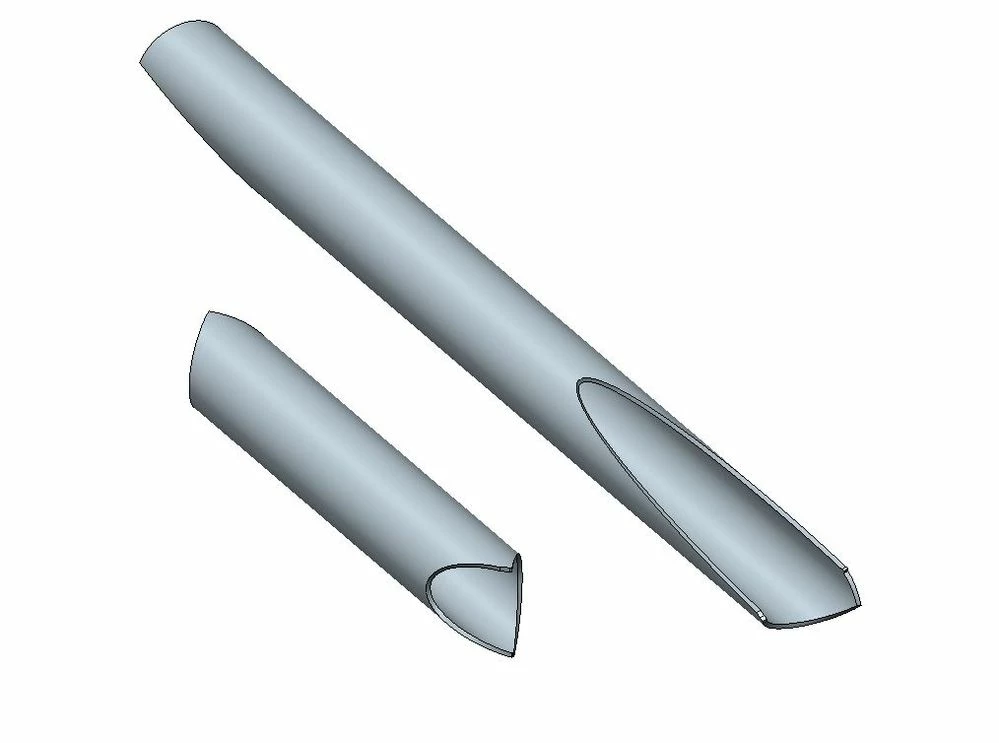

There is no easy answer for this but for the most part, fabrication of fitted pipes is pretty much what the Creo operations do.   For normal edges you need to have the sheet metal functionality.  That might be another fish you don't want to fry.  I'd say scribe the inside and the outside and run a sweep through both.

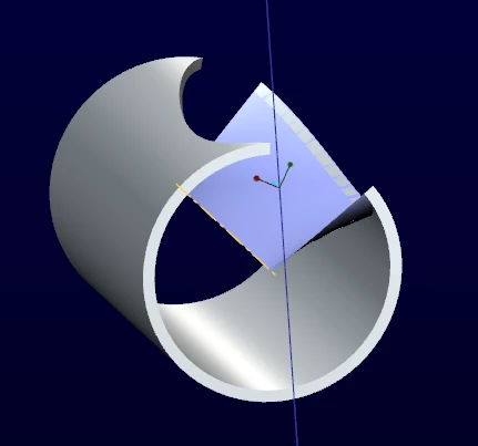

Here it is. The one from the picture (worst case) and another with a more common geometry.
Forgot to say I'm using Creo 4.
BHOoi
March 7, 2018
I approached this using surfaces:
1. Create the outer surface of the pipe
2. trim sut using the outer edge
3. Thicken it to the correct thickness (1.25). With this , the cut is perfectly normal to both outer and inner surface.
I attached here the Creo2 files for your reference.

What you're talking about is NOT always normal to the surface if you mean the surface of the tube you have shown.  It's more a boolian operation of a cylinder removed from the tube shown in the diamater of the tube it mates with that you haven't shown.  This should be easy if the tubes are of a constant round cross section.  I would model all these tubes top-down using trajectory curves in the center of the circular cross section that you can use later to sweep cuts along to get the shapes you want.
March 7, 2018
What is suggested follows my earlier suggestion... using sheet-metal functionality.
Sheet-metal does just that; creating thickened surfaces.
The attached file proves that these surfaces are normal.
I projected and pulled an extended surface to the centerline.
