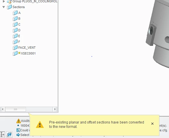

Is there an option to convert the existing cross sections automatically to the new format (e.g. Creo 3) when the file is opened?

Do you mean to change from the previous procedural cross-hatch methods to the defined pattern method?
If so, it seems unlikely to happen.

No, i'm searching to make this operation automatic when an assembly is opened:
