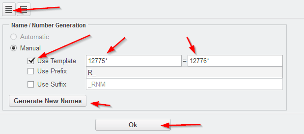

You can rename all the files at once.
In the main assembly do a File->Rename, give it a new name, ok, now a window appears:
Select all->Use Template->12775*->12776*->Generate New Names->Ok
Done.
You can use the "Save a Copy" command in the same way.
Jose
Done.
Jose
