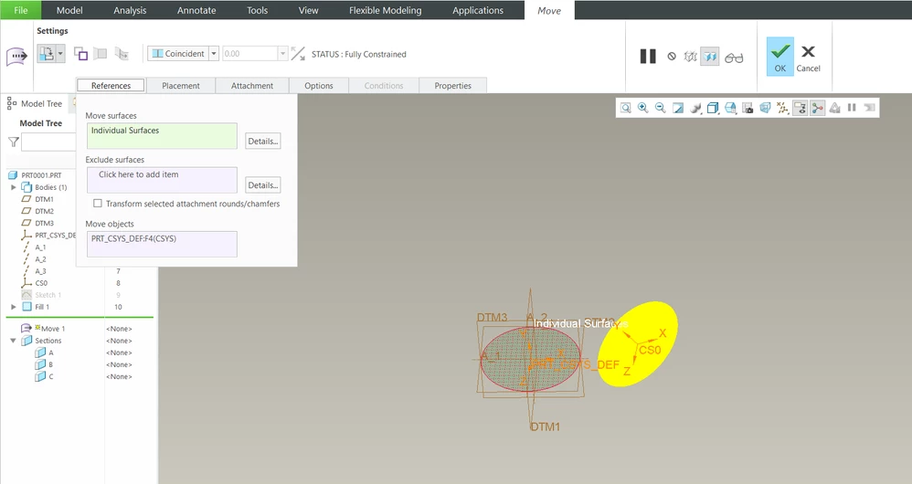

Hey Creo gurus,
What is your best method to copy - move a surface (or quilt) from a CSYS location to another?
Copy - Paste Special - Transformation only allows one DOF at a time. I want to just select an original and new CSYS to place a copy of this surface from CS0 to CS1.

The functionality you want has been moved to the flexible modeling tab. I do not recall when they moved it there. It is now the current implementation of the old surface transform function.

VMcD14-AlexandriteAuthor
Dec 19, 2022 4:20 PM UTC
Thank you, this Move function is the only one I found.

Dec 22, 2022 3:30 PM UTC
To achieve what you want to achieve (transform a copy of a quilt based on CSYS alignments), you can use FMX-Move and:
  1. select the quilt into the references collector (This is the recommended/best option. Typically you would want to do that for a body as well). That way it is selected as a “quilt-object” and not as a collection of surfaces
  2. If you do select it as a collection of surfaces, then you have to uncheck the “attachment”-option (unless the quilt is a closed quilt in which case it couldn’t attach to anything anyway).
Please have a look at this quick video illustrating the workflows:
Will check with my colleagues to get the article updated.
