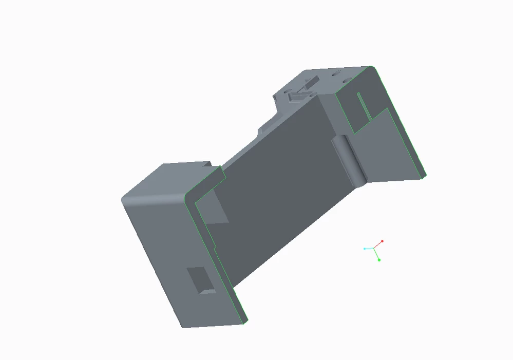

I am having some trouble copying and pasting an entire part. I want to take this part in picture 1 and copy and paste and identical part on the back side (highlighted in green in picture 2) of this part.

Do you want to copy-paste or do you want to mirror the features?
18-Opal
October 4, 2017
I agree with Stephen.  You are probably better off mirroring the entire part, about the desired surfce or plane.  See the Help Center document for additional information:
About the Mirror Feature
Amit
October 4, 2017
If you would like to put the parts in a package, for shipping, for example, then you can simply assemble two parts back-to-back.
Otherwise, you need to say more about your specific requirements, in order to get the best response from the community.
In this case, there are obvious questions about the non-symmetry of the part, for example.

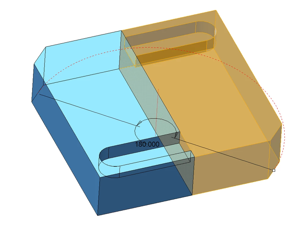

This is how I would do it, by Copy/Paste special with 180-deg rotation.

October 5, 2017
...or you could create a Circular Pattern 🙂
