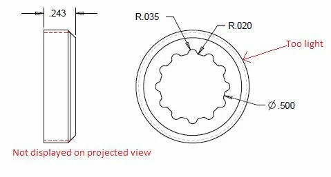

Hey all, I've searched around for a solution to this but am coming up empty and could use your help.
I've got a bunch of screw machine parts with a variety of threads. I'd like to use cosmetic threads to keep things from getting cluttered on smaller threads.
Two things:
1) how can I increase the line weight of the dashed/hidden line of the cosmetic thread in the drawing? when I export and print the dashed lines are very light and could easily be missed by an operator
2) is there a way to show external threads in a side view without using a cross section?
Thanks for the help!
