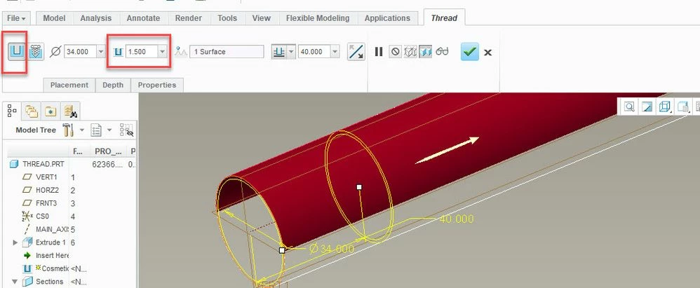

The cosmetic thread feature using the SIMPLE THREAD asks what pitch you want, so you just key it in.
You can't use the standard thread because it's not standard.
