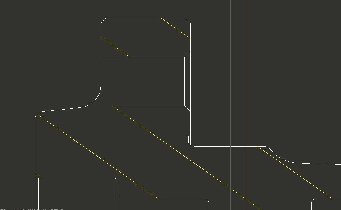

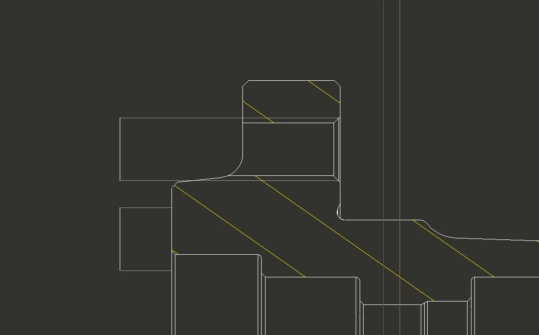

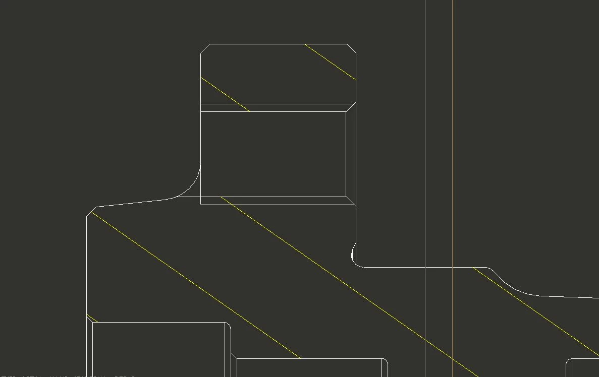

I'm having a problem figuring what I should do for a part that the thread blends through the part. I attached some jpeg of what I'm talking about. Please help.
Best answer by BillChapman
Can't remember the exact version that fixed this issue in the hole feature (maybe WF 4.0. Now when you create a new hole the cosmetic thread is handled correclty with no additional action. If a new hole in WF 3.0 does not come in correctly you need to trim the sufrace, or create the cosmetic thread separate from the hole and you can choose "up to surface" for the depth.
April 10, 2014
diggs1-VisitorAuthor
April 11, 2014
how do you do trim in drawing
