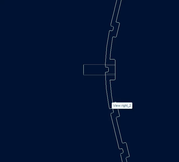

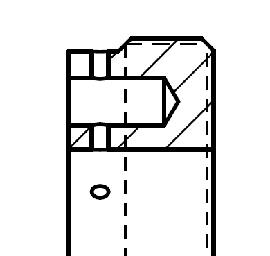

I'm having difficulties showing threads correctly on the drawing. Here are some screen captures to show what my issues are.
Here is what the cosmetic thread looks like on the model.
Here is what the cosmetic thread looks like on the drawing.
And here is what the .pdf file looks like when generated.
I do not want the vertical lines of the cosmetic threads to display. Is there a way to get rid of them or am I doing something wrong?

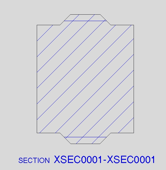

Make a cross section?
jmayer1-VisitorAuthor
November 2, 2012
Here is what my section looks like.

MIGHT be able to erase the line under the layout tab, under line style. Why though? The line DOES exist because it's the start of the thd. Yes, it's not like doing it old school on the drafting board, but to me it's not a huge deal to see things like that on a dwg. I have my tangency lines set to phantom in most cases in dwg views, which is definately not old school, but I think adds to underestanding the organiclly sculpted shapes we have today.

I don't think you can turn the vertical lines off. I just leave them alone. Annoying as it is.
