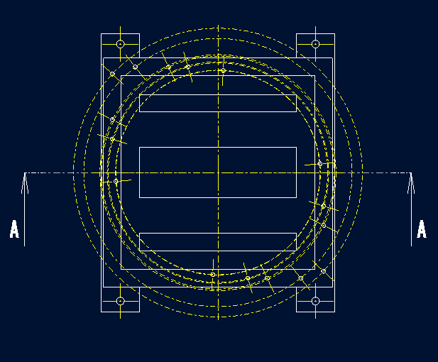

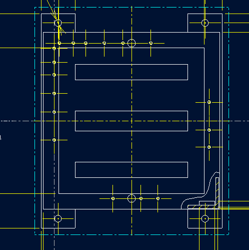

I have a problem with cotation of holes made by a group pattern around axis.
I would need to use linear cotation of those holes but after the pattern is done it will switch to radial cotation.

July 1, 2014
Tomas,
I think that nobody understand you because you are using the word cotation (tipuji, že česky je to kótování). Maybe dimensioning scheme is the right word .
Also dimensions are missing on you pictures. Therefore nobody knows, what do you want to get.

July 1, 2014
There is a switch in <detail>.dtl that creates the radial axis pattern.
radial_pattern_axis_circle *NO/YES
I am not sure this is a live switch. You have to play with that. It lets you create radial patterns when a hole is patterned axially. By default this is NO, so it is set in a config file somewhere.
July 2, 2014
it seems somebody understood very well.
Thank you very much....
