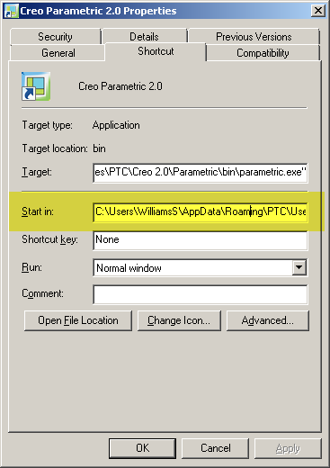

I installed CP4.0 M010 and immediately went to load/setup my existing config file.  I load it, everything looks fine.  When I exit out and reload CP4, I have to reload my config settings because it's not saving.  I tried "export", but that doesn't work.
What am I doing wrong?

Right click on Creo 4.0 shortcut icon > Properties

ER,
I think your config file is not in start in directory for Creo.
You may place config.pro in startin directory of Creo (Right click on Creo Shortcut and check the startin)  OR
Change the start in directory to folder in which you have config.pro.

Hi Mahesh,
how would I change my start in directory?

Your Start-in folder is on your icon.
