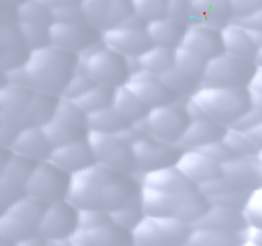

Hi all, i have received an igs model which i am being asked to reproduce in Creo 3. The model contains some very rough bumped up surfaces, you might describe as 'cratered', like the surface of the moon, so to speak. These surfaces are actual surfaces, not just texture applied to the surface for rendering purposes. This is something i have been asked in the past, but i have always shied away from, stating it can't be done with pro-e/creo software. I ask this forum again, in the hope that something may have changed. Can a surfacfffe texture like this be modeled in Creo (quickly)? In the past, it was suggested using the old 'free form surface manipulation' found under 'Tweak Surfaces', but this would be far too time consuming, and i could never get the desired results when i tried it. Just out of curiosity, does anyone have any suggests as to what software might have created such a surface in the first place.
There is also the possibility of using the 'Warp' feature & sculpt i suppose, but again, very time consuming & very difficult to achieve the desired result.
Regards
John

I ran into this once on a baffle inside a muffler.  I believe the surface was created in Catia and it was very, very heavy to work with.  I ended up just copying the surface and merging it with other ones created in Pro/e.

I would agree that the easiest way would be to use the IGES surface to create the surface in a CREO file.  (Use Solidify to cut or create solid)

Thank you for the swift replies. Sadly, it isn't that easy. When I said I had to reproduce the model sent, I was been economical with the true. It not the model I need to copy, but the surface type, i.e. a cratered effect. The model I have to create is a totally different shape to the igs model I have, that was sent for reference only.
What I was hoping for, was to make a plain model, then pick a surface set & apply a deformation in the same way you might apply texture to a surface using the appearance manager.
John

Did you try Surface Edit tool inside Style feature? If you have single patch surface - it can provide you high level of details
in editing the surface.

The program you're looking for is Delcam Powershape

Thanks for the info. We have PowerShape here. I just showed the video clip to our PowerShape guys, & they almost had a heart attack! I joked that they would have to do the job. Again, just as with Creo, they claim you need some advanced surface licence to do this, which they don't have, or are they BS ing me?

An stl would never be able to produce that texture in any useable way. The resolution required would be immense. Also, the file would be so data heavy that the machine trying to deal with it would crap out. To me, that image seems to be the IGES result of a high resolution scan.
What I asked was if Delcam has that canned texture tool in it's tool box that allows that random texture to be added to the mold/die as a CAD/CAM native feature. (I.E. a surface that could be exported back to out). I briefly looked at their site and did not see anything that indicated it could do that. Typically that type of texture is "applied" to the actual physical tooling surface by some means (Chemical etching, bead blasting, etc...)

I checked my notes and remembered that we ended up getting this work done with the mold maker. They used these two:
Magics, the Most Powerful STL Editor | Software for additive manufacturing
http://www.geomagic.com/en/products-landing-pages/re-designx-wrap
If you don't like STL then Geomagic will work with STEP or IGES
I can't tell what the scale is on John's image. If it's super fine detail then yes, they're going to use etching or electro-deposition or  Mold Tech textures

You may have moved past this issue by now. But I am still curious. How big would one of those craters be? And does it have to be 100% random or can there be some symmetry?
July 9, 2015
Hi Matt, looking at the model I was sent, I would say the maximum depth of crater was 2mm, & the pattern looks totally random. I spent a little time looking to see if the pattern was repeated & as far as I could see, it is not.
Greg, thanks for your thought provoking replies, I'm not sure our PowerShape guys appreciated them as much as I did ha ha. To answer your query, I would suggest the scale of the image I initially posted, to be approximately 2:1
