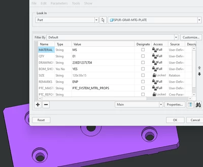

Dear,
Good day
Can you please help me to make map key as full fill below requirement.

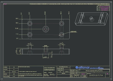

We created drawing file with parameter as below .
Now I want a to create individual part  pdf & step file (drawing file having more pages ,so only one part need to convert pdf and step ) by using map key & that file name should be drawing number which I provided in parameter.
Thanks with Best Regards,
Sreelal Sreevalsan
Mob: +966-571124829
May 28, 2024 6:55 AM UTC
Using a parameter and entering that as the file name in a mapkey is tricky, unfortunately. These things can be done, but it usually involves things like saving text files to disk and using a BAT file to read them, sending keyboard commands to the OS or running an Autohotkey script, or something like that. The easier way to do it is to just pause the mapkey when it's time and let the user enter the file name themselves.
Besides that part, the rest should be easy. Just record the mapkey and do the steps yourself.
