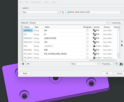

Can you please help me to make map key as full fill below requirement.
We created drawing file with parameter as below .

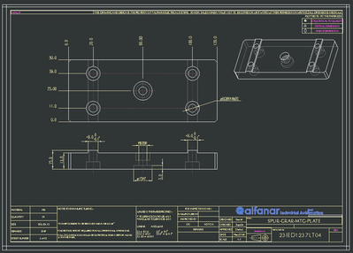

Now I want a to create individual part  pdf & step file (drawing file having more pages ,so only one part need to convert pdf and step ) by using map key & that file name should be drawing number which I provided in parameter.
