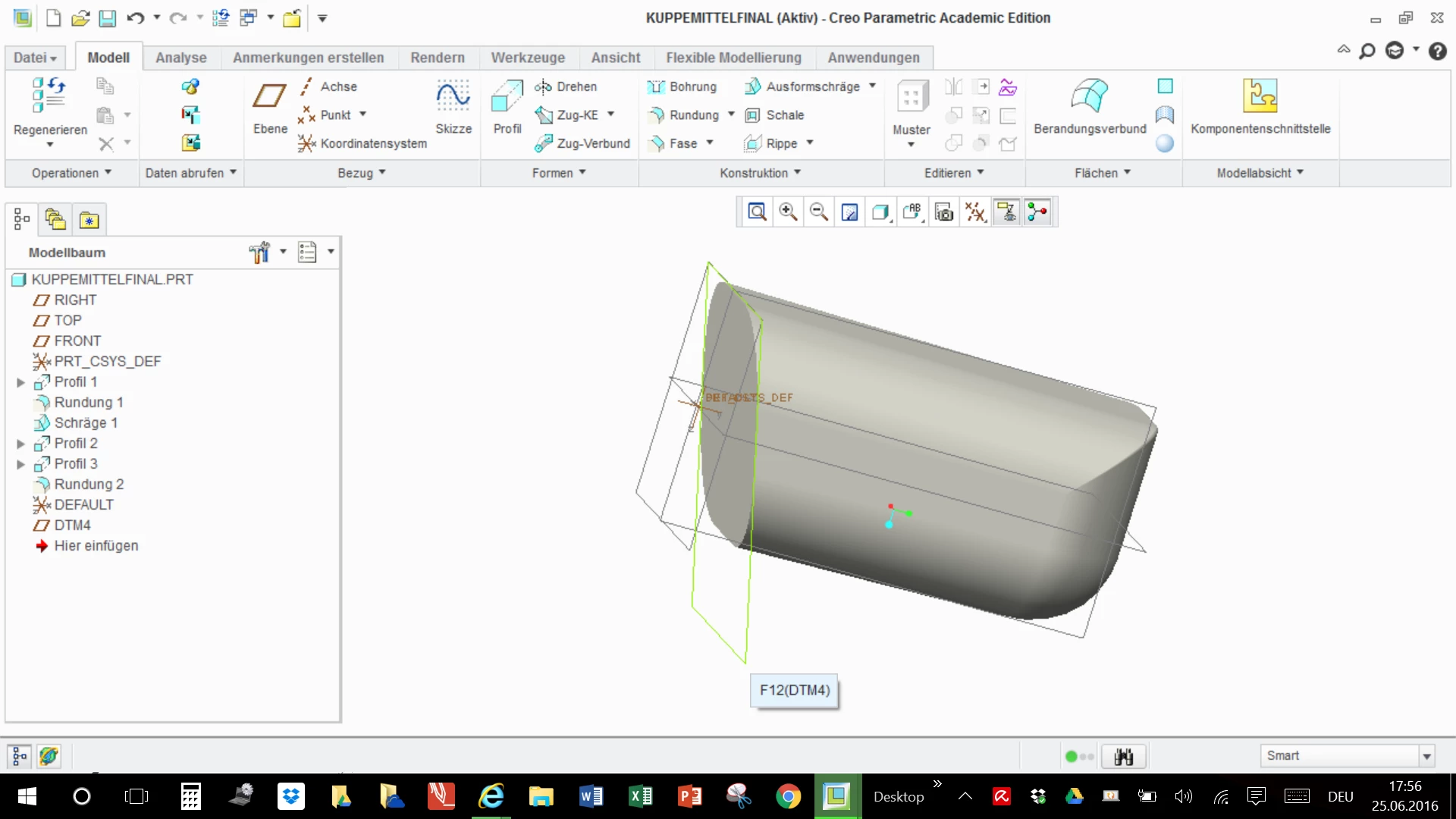

Hi
I need to create a new plane 90 degree to another one. I need it to connect two parts in thee assembly.
Attatched you will see the plane i already created direcly on a surface.
Tqvm
June 27, 2016
to be able to create new datum plane perpendicular to DTM4, you have to select DTM4 and another reference(s) (for example 2 points/vertices). Create additional references, if it is needed.
MH
June 27, 2016
you need to use your angled plane and then an edge or axis. After selecting the plane and edge/axis you select Normal in the Datum Plane properties. Using an edge the 90deg plane is forced to follow the feature that created the edge. Using an axis the 90deg plane will go thru the axis. If you then move the axis the plane will follow.
In the picture the top most plane is following the edge of the extruded feature and the bottom most plane is following the axis i have created.
Regards
