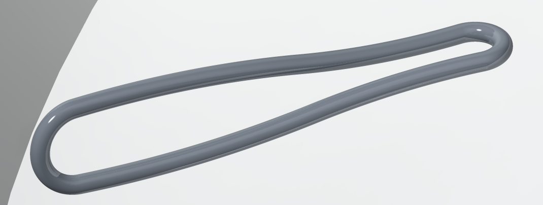

I am working with lifting equipment and need to model lifting slings. Creating a straight lifting sling is very simple when using the circumference dimension and letting the centre-centre distance be variable. See the picture below.

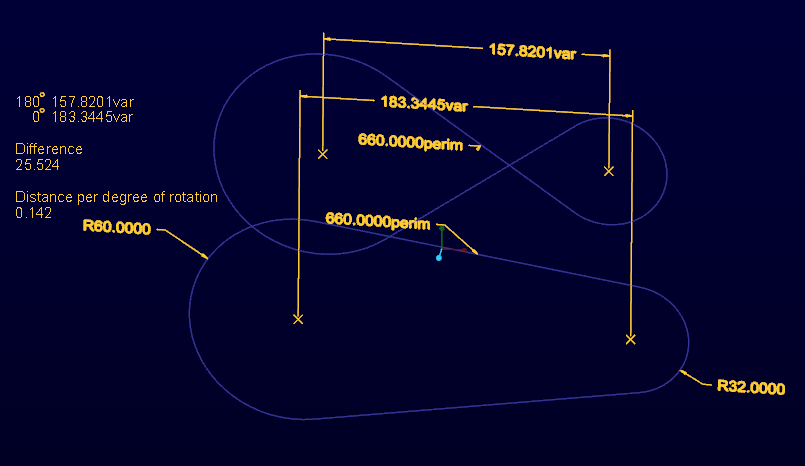

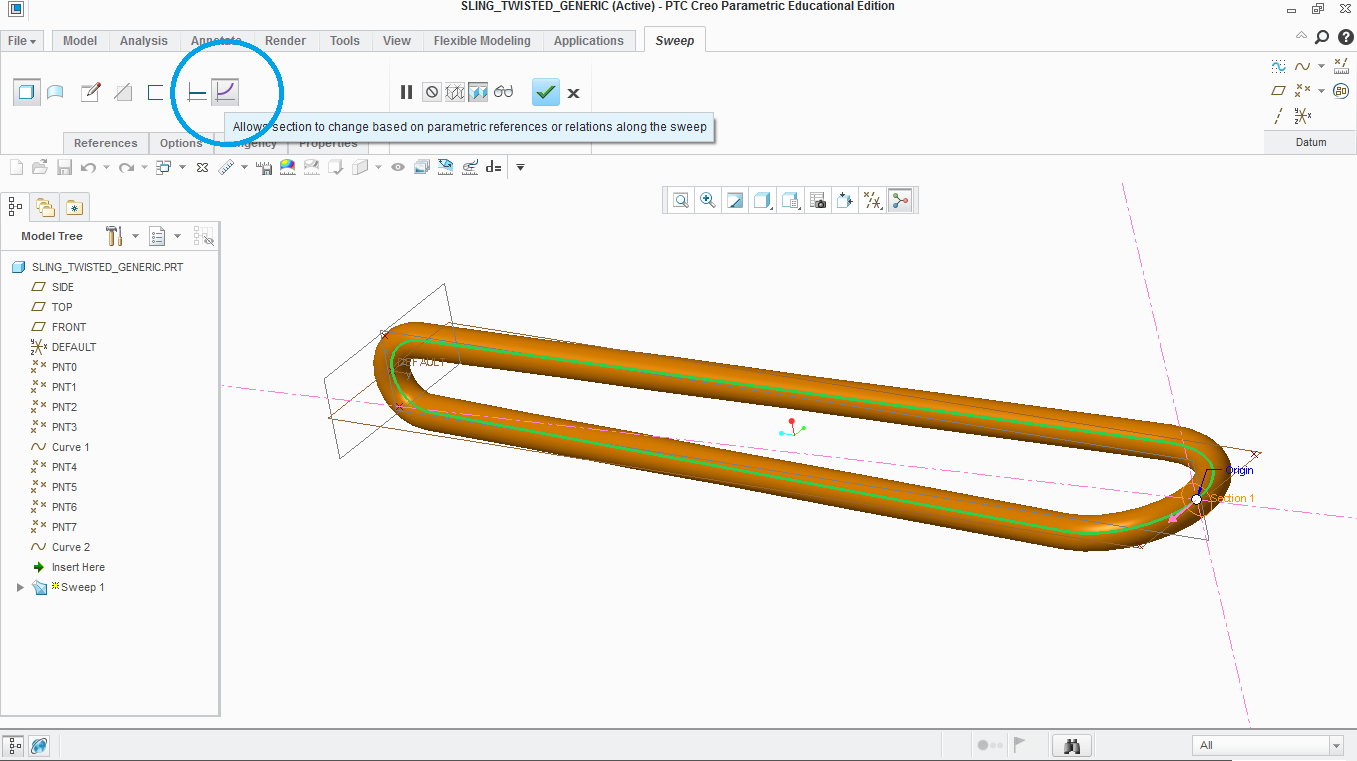

The challenge is creating a similar sling, but with a 90° twist. I have tried the pipe feature, sweep and swept blend, but I haven't succeded in creating is as one feature. It is possible to create it with two features, but it isn't very elegant. See the attached model.
Is there an elegant way to create a twisted sling? And is it possible to control the curve length and keep it constant?
