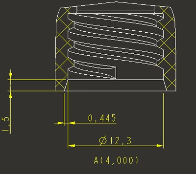

There are some parameters for scale available in drawing mode. This is for a detailed view "A" with a scale of 4
The syntax of the note shown above will look like this in a text editor.
{0:&view_name}(&det_scale)
In general use this:
The drawing parameter scale_of_view_x evaluates the drawing scale of whichever view has name X.
For example, to call out the scale of a view named DETAILED_BAR, type &scale_of_view_detailed_bar.
