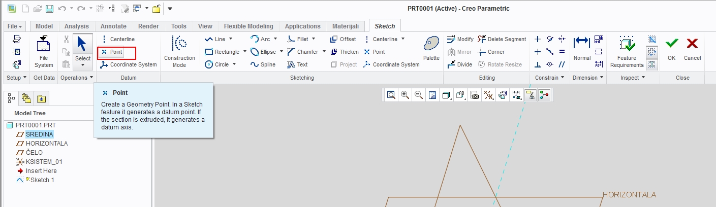

In WildFire 4.0 I could create a "Sketched datum point" but now I can not figure out how to do this in Creo 2.0. Is it possible? I have attached a screen shot of the tool in WildFire 4.0.

You can just create sketch and in it you have option to put point. When you complete sketch you will see point.

Create a sketch feature and add a geometry point. When you finish the sketch, it creates the datum point.

Yup that is it.. I had my "Datum group" turned off and was picking the point tool in the "Sketching group" in the Sketcher Ribbon by mistake.
