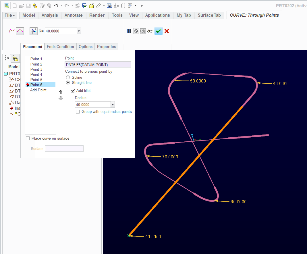

How does one create a curve using Multiple Radii on a Whole Array (Offset CSys Datum Point)? I only get to specify one radius and can find no way to edit or redefine the curve to specify more than one. I've heard that Multiple Radii may only be available for curves through Single Points. Is this true?

If all your points are showing up as a single point; right click on the point and choose the last option. This should make all the points individual and each fillet can be dimensioned. Careful thought, I just crashed Creo doing this.
August 19, 2013
It takes some work to disassociate the points from each other, but it works. To be clear, you right click on the single entry in the dialog to expand to individual points. Then you have to turn of the grouping for each point.
