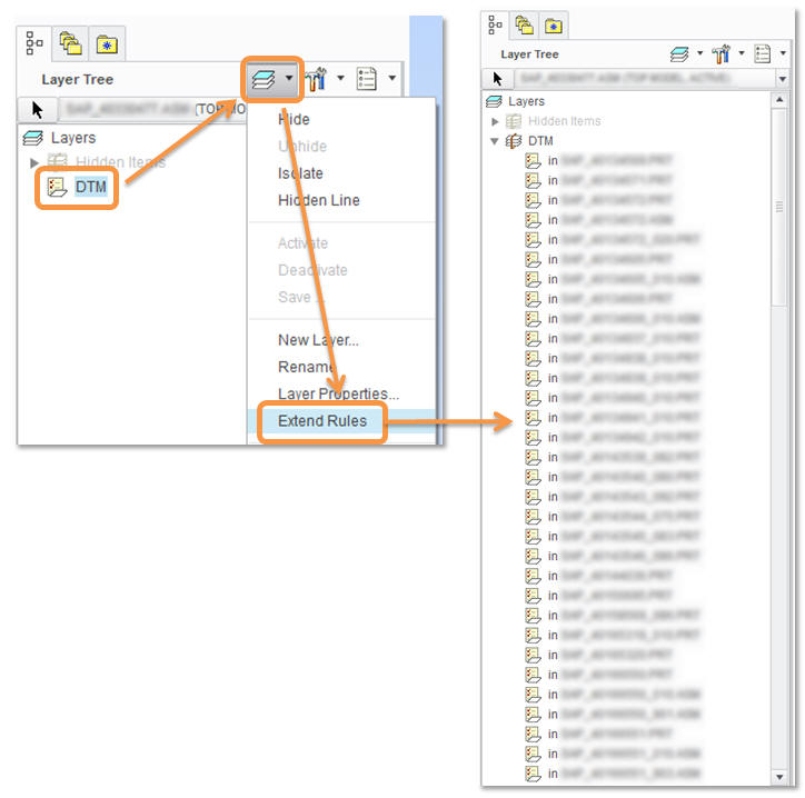

Is there a way to do this inside an assembly? It seems to work fine at the part level, but I would like to hide datums at the assembly level. I tried checking the "inlcude sub models" box and when I preview results there are hundreds of datums. I click "OK" and the layer tree only shows datums that are created at the assembly level (i.e x, y,z defaults). Does anyone have any input as to why this occurs?
Aaron
Best answer by Constantin
Hi Aaron,
there is also a functionality that allows you to create layers on part level very easily.
Create a rulebased layer on assembly level then simply "extend" the rule to all parts.
This will crate a layer with the same name and rule in each single component.
If you do this for all desired layers you end up with a very clean layer model.

Hi Aaron...
Which version of Pro/E or Creo are you using? The screenshot below from Creo Elements Pro/5 (Wildfire 5) allows me to see down into an assembly's sub-components to view all layers.
It sounds like maybe you're on Creo 1 or 2 and things are not behaving correctly? Is this the case?
Thanks!
-Brian
