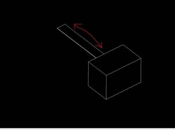

Hello all.  Hoping you can help me find a solution to a drawing view problem we are having  Using Creo 3.0.
I have a sub-assembly that, depending on the configuration, has a single part which can protrude out much further than the main components of the sub-assembly.  This forces us to scale the entire sub-assembly down to fit it into the bounds of the drawing sheet.
  The part is rather minor as far as representing it in the drawing, and what I would like to do is find a way to do a partial or broken view of JUST the part in the sub-assembly drawing so I can keep the view scaled larger than I would be able to with the full part being visible.  Moving the part to another sub-assembly would not be an option, and I would rather not hide it either.
Is there a solution for this?  Thanks in advance!
A dumbed-down representation.  The main body represents a bundle of many parts, while the protrusion represents a single part that extends away from the majority of the sub-assembly.  Depending on the configuration of this sub-assembly, the part in question can be much longer or shorter.

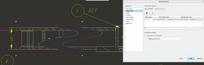

In the view properties under visible area, you can use broken view or partial view.

You would be controlling this in the drawing view, it only affects the view that is set to broken view (or partial view).
So you would set the assembly view in question to broken. It has zero affect on the part or assembly model.
January 8, 2018
What about using a partial view with the boundary set to the main part of the assy.  When this part isn't present, it'll just look like a normal view, when it is a spline will show indicating that it's cut off.  This assumes that you don't need to see the part of that component which is cut off.
