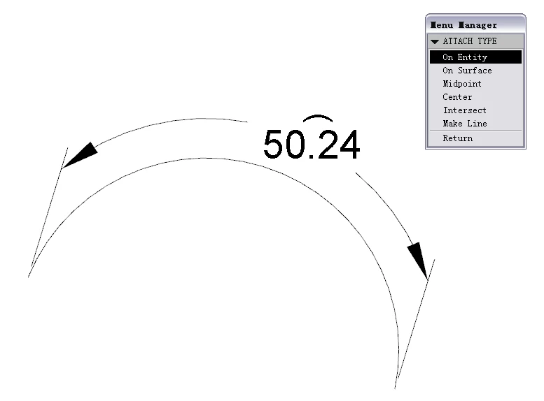

hi all,
I know I've done this before but can't for the life of me remember the method.
I also can't remember if I did it in the drawing or sketcher 🙂
Perhaps my age is just catching up with me
W4
May 20, 2011
First, pick the arc and the two ends, and then click the right key of your mouse, and click the arc length, right key, ok
see the figure.
