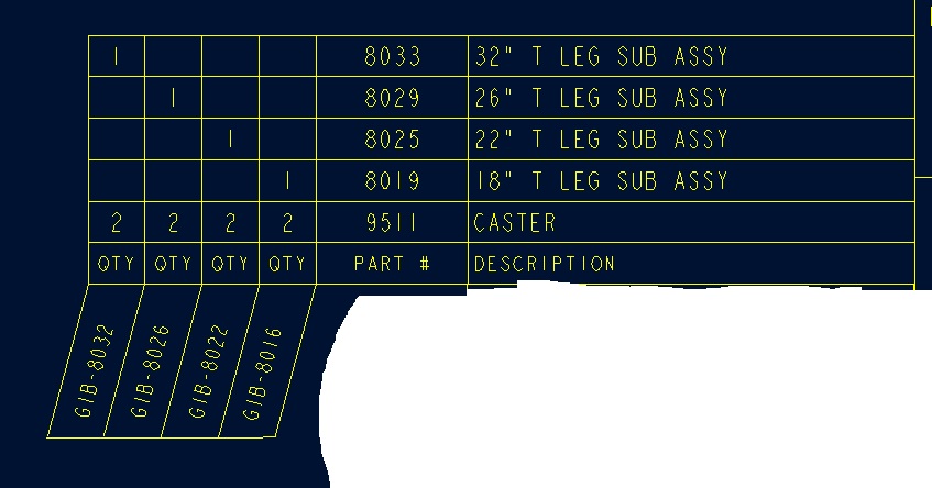

You can get halfway there. You can have multiple models in the same smart table with Repeat Regions, but you can't generate BOM balloons.
Create a table with a Repeat Region like you normally would for a Bill of Materials. Create multiple columns for rpt.qty. Then go to Table > Repeat Region > Column Model/Rep. Select one of the rpt.qty cells, and in the File > Open dialog box, select the assembly that should drive the quantities for that column. Rows will be added to the table as necessary for components that appear in the added assembly and not in the starting assembly.
