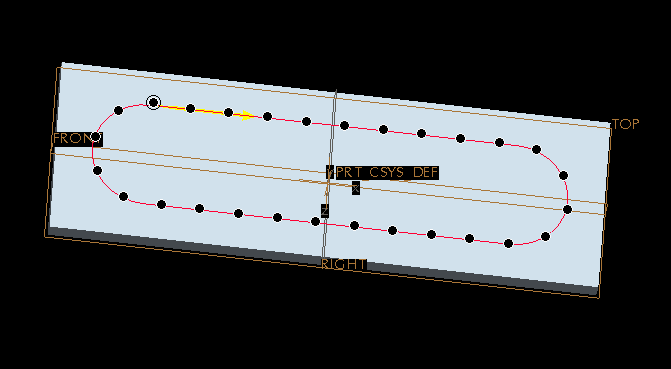

Hello Buddies
Kindly tell me how to creat holes in ellipse shape. I need to pattern the hole in ellipse shape. Please find the image file. Kindly reply its very urgent..

January 27, 2010
Firstly, I believe that's an oval, not an ellipse (an ellipse is a
circle stretched in one axis). If you had wanted an ellipse, it might
have made sense to use some equations somehow...
There are several solutions.
The easiest, assuming that the points you show are patterned, would be
to create an axis through the pattern leader of the points, then create
a hole on the axis, then reference pattern the axis and then the hole.
Reference patterns are extremely powerful and very useful.
If the points aren't patterned, you could create the first hole and then
copy and paste it onto each point (again, you may need to create an axis
first).
Or you could ignore the points completely, create a semicircle pattern
of holes and a line pattern of holes, and mirror each of these.
HTH,
Jonathan

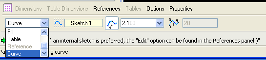

January 27, 2010
Ingersoll,
1- Sketch the curve
2- Create the hole on an endpoint (See yellow arrow for start point)
3- PATTERN -> CURVE (specify the spacing)
[cid:image001.gif@01CA9F3F.2B653710]
[cid:image002.gif@01CA9F3F.2B653710]

January 27, 2010
It can, as of WF3. It's very useful - suppose you want 8 equidistant holes,
centered on a part, but want to be able to have the distance change as the
part length changes, since you're still iterating your design. Sketch a
straight curve, centered on the centerline, create your hole on one end of
the curve, select pattern > curve > select the curve, change the criteria
from distance to number of holes, set the #, voila!

January 27, 2010
Try pattern on curve. I just tried it using your shape for the curve and
it is very easy!
