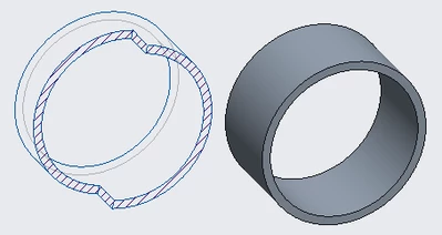

Aug 21, 2023 2:04 PM UTC
Offset x-section enables you to get following view. Unfortunately section view cannot be displayed in shading mode.
