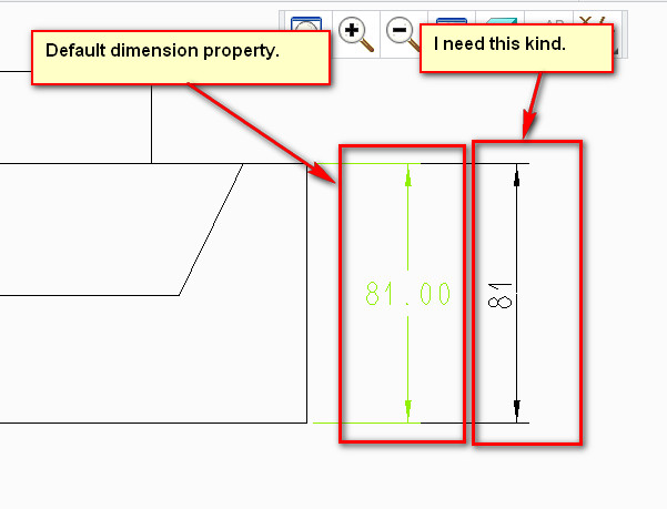

When I create dimensions in drawing, the dimension format is NOT what I want. Thought I can change the dimensions properties but I have too many dimensions to edit. Is there anyway like change config.pro file to achieve the following intention?
1. the zeros behind points don't shown
2. the text orientation is 'Parallel to and above leader'
Please below image.

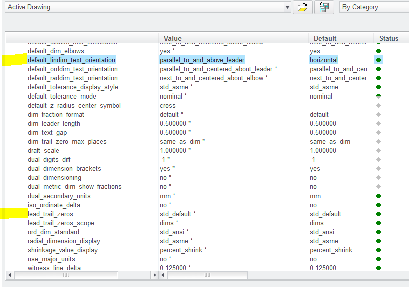

Sorry, I had to go look this up...
There are a lot of controls for settign specific ISO dimensions in the detail.dtl file.
Here are a few of the basics you are asking about....

if you change from ASME to ISO, you should get the results you are looking for.
