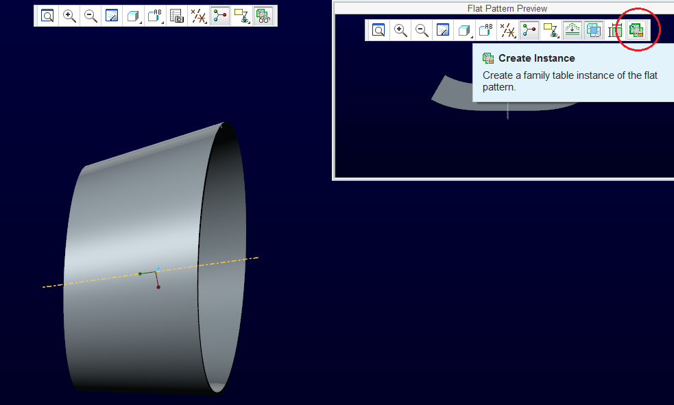

A: The unbend and flat pattern tools have been greatly improved to facilitate the creation of the flat states. Single button action to create a flat pattern family table instance or part simplified rep to show in detailing.
Is there really a single button action to create simplified rep of flat pattern which can be shown in drawing?

The answer is no. There is not a single buttone to do so without the creation of a mapkey. However one you create the simplified rep, it is done for all family table members.

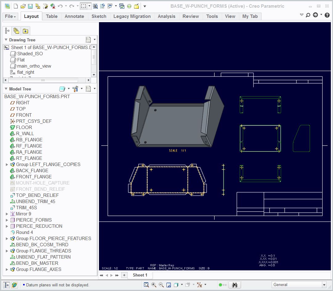

The issue i see with this though is that your master rep is flat not formed. I have brought this up at the TC meetings a couple of times and presented on this in January to one of the project managers and the sheetmetal TC. Hopefully this is fixed sooner than later.

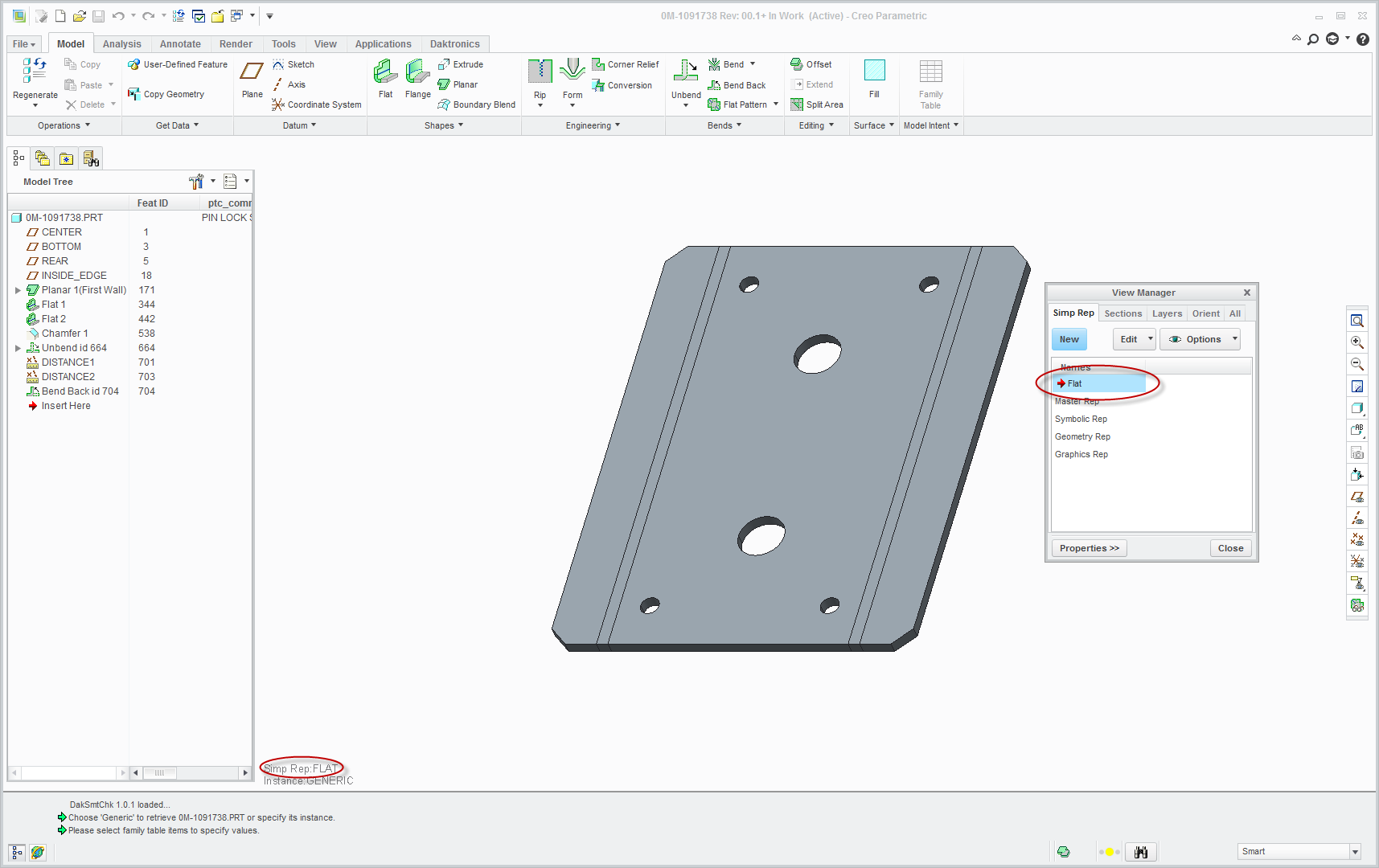

Maybe you can be more specific about "which" simplified rep you want. By default there are 4. When you create the family table instance, you also get 4 "simplified reps" in the View Manager. Technically, this answers your question but there is a family table involved.
I have done drawings using view states rather than simplified reps or family tables. If you avoid the "flat pattern" feature and use unbend and bend back features, you can easily make a view state with the flat pattern (unbend) view state and by suppressing the "bend back" feature in that state. This way, your default master model is in the bent, or as-used state.
I am always leery of "one button" claims as they are often not ideal. The method I describe here is actually quite simple if you have the discipline to make sure your model will support the unbend/bend-back features.

I should clarify. When i said the master is not formed, that is when used with the flat pattern feature and not the use of unbend and bend back features. When using the later it works fine.

Create the simplified representation, then create the flat pattern feature. Done.
What it actually does is to suppress the flat pattern feature in the master rep. So even though it works in the session, it does -not- work after it is saved and removed from memory. The suppression state is not maintained with simplified reps!
Video Link : 3876
What I did after that was to add a bend back feature after the flat pattern. And if you actually -try- to do this, this too will fail because it maintains the flat pattern as the last feature. -BUT- ...if you add the bend back feature in a simplified rep, it adds the bend back feature -after- the flat pattern feature. THIS the system maintains after a save and erase in memory.
Video Link : 3877

The moral of this whole post is that the family table method is likely the method referred to when a "single button" process was suggested. I am not one to use family tables in practice (in 15 years, haven't yet!). I am also not certain that the trick to placing the bend back feature after the flat pattern feature will be stable in the long run as Creo gets updated.
