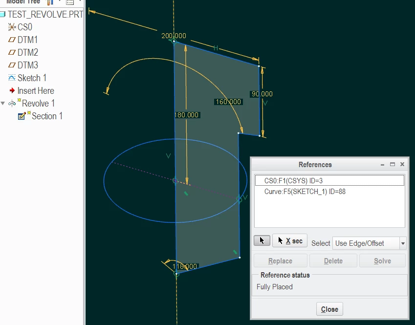

I don't think what you are seeking is possible in Creo.  The dimension you are trying to show belongs to the planar sketch (for sake of argument, this sketch lies on the "FRONT" plane).  Creo isn't smart enough to show it as a radius dimension in the TOP view which is orthogonal to this sketch.
If your company insists on model dimensions only, then you can do something like this:
1) create Sketch 1 (on TOP plane) that contains the radius dimension.
2) use the Sketch 1 circle as a reference in the revolve's Section 1 (which lies on FRONT plane):
Another method would be to just create a reference dimension in the model using the annotation tools.
Either way, you get your radius dimension that can be "shown" in the drawing.
But isn't it so much easier just to make the extra radius dimension in the drawing?

Crumb... I completely missed the continuation image.
Is this something set in the dimensioning settings?  Not familiar enough with config.pro settings outside ASME.
Be sure that the radial dimension that you place in the sketch is actually related to a revolve,
If it is a real radius dimension, then it should allow you to change it to diameter after creating it in the sketch.
If it is simply a linear dimension that took on baseline dimensioning, then that could be the issue.
