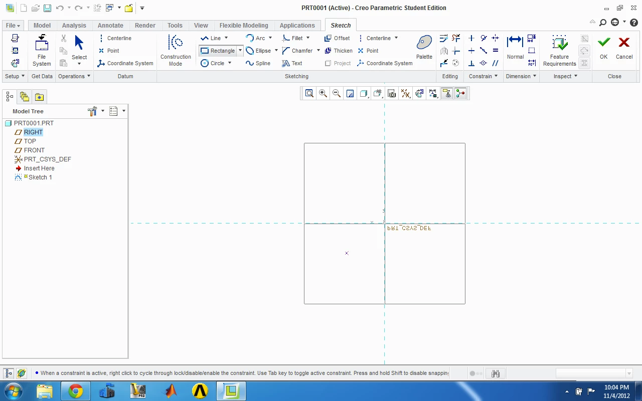

Hi there,
I have recently installed Creo 2.0 from the PTC website, I am a student and I recieved the educational activation code.

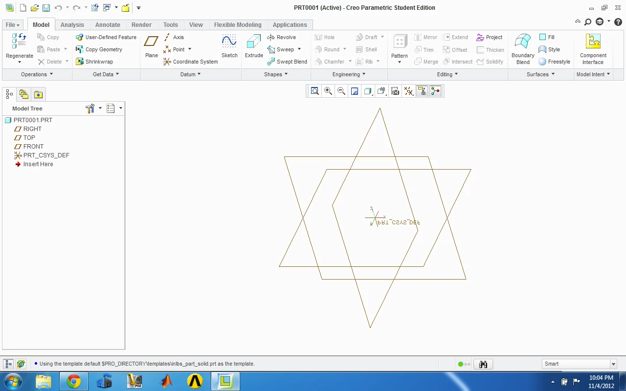

Everything installed but when I went to open Creo 2.0 Parametric everything is flipped over the horizontal axis. When I go to sketch the cursor is mirrored to the other half of the screen.
Has anybody has this issue before? And if so how can I fix it?
Thanks.

Thank you Martin this is working
Only problem is however I don't think it's the graphics card, I'm running a new macbook pro with Parralells virtual machine running Windows 7 64 bit.
I am using ANSYS 14, Autodesk Inventor and MATLAB day to day with no problems, only a problem in Creo 2.0.
Is it a problem if i just leave the graphics win32_gdi in the config.pro file?
Again many thanks.
