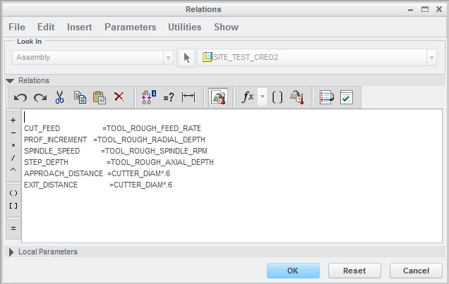

I should state that the parameters that do not fill are relation based and taken from tool information:
CUT_FEED =TOOL_ROUGH_FEED_RATE
PROF_INCREMENT =TOOL_ROUGH_RADIAL_DEPTH
SPINDLE_SPEED =TOOL_ROUGH_SPINDLE_RPM
STEP_DEPTH =TOOL_ROUGH_AXIAL_DEPTH
APPROACH_DISTANCE =CUTTER_DIAM*.6
EXIT_DISTANCE =CUTTER_DIAM*.6
Bill

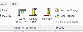

This is a trick I found in Wildfire 4 and it appears to behave the same in Creo2. You can create relations in the process manager that will apply to all toolpaths, it creates feature level relations for each toolpath which are viewable via the relations editor by selecting feature, and the toolpath.
Use the process manager:
[cid:image002.png@01CE40FB.979D4B00]

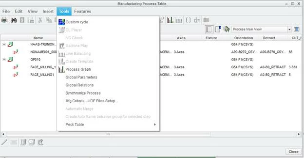

Open global relations:
[cid:image006.jpg@01CE40FC.007BC250]
Type your relations in here:
[cid:image005.png@01CE40FB.979D4B00]
When you check out of the relation editor it will apply these relations to all existing toolpaths.
