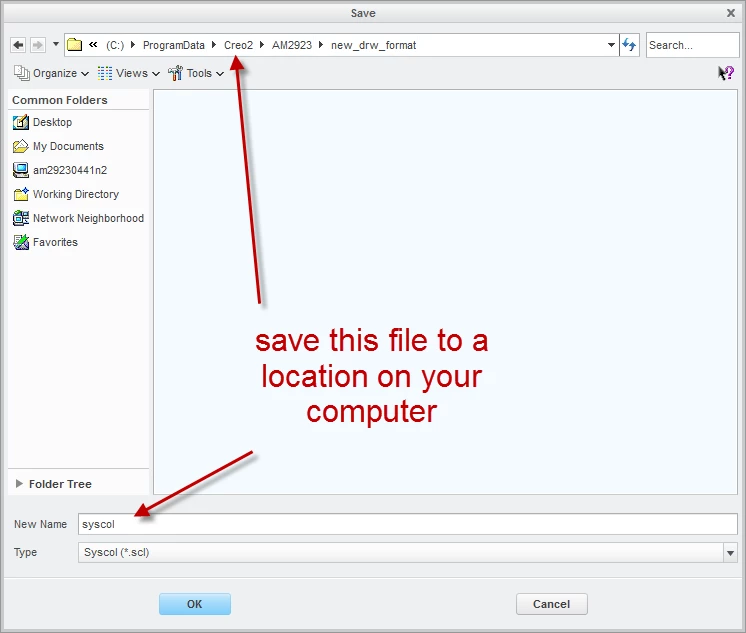

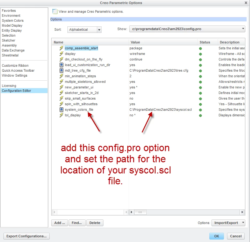

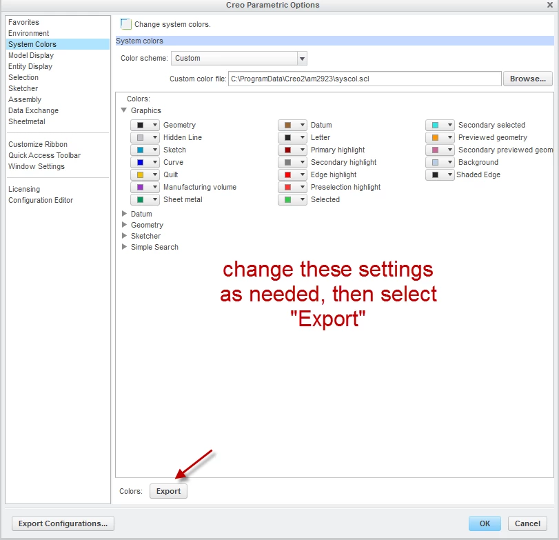

You should be able to copy your old syscol.scl file from your previous working directory and paste it into your Creo2 working directory. Set your config.pro setting for system_colors_file "your new path for the file" and you should be set.
Here is how I set my color map in Creo2 for new colors.
Select "File, Options"
[cid:image001.png@01CF589F.CA16A600]
[cid:image002.png@01CF58A0.34916830]
[cid:image003.png@01CF58A0.D5596150]
