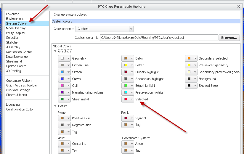

Hi all,
I need one requirement to take the pictures.
When i have selected the required datums (Planes, axes, csys), The datums are displayed in green color only. But i want to change the highlighted datum color as a red color. It will helpful to take the pictures for me.
Pls suggest how to change the highlighted datums color in creo-2
Thanks in advance.
StephenW
March 6, 2017
FILE - OPTIONS - system colors.
change the "selected" option to your preferred color.
