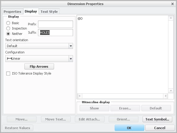

Thanks to Janet Grove I have the answer for the HOLES problem.
Go into the properties for the p42 dimension and remove the "HOLES" suffix.
