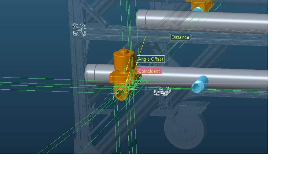

Hello , I recently got a laptop upgrade with Windows 10 (NVIDIA  Quadro M1200 card with up to date driver ). I am having issues with annoying lines when working in assemblies while constraining a part. Any ideas if there a setting I can change to get ride of them ? My old computer had Windows 7 and did not have these issues.
Thanks !

add following option into config.pro file temporarily.
graphics  win32_gdi
If the problem disappears then it is related to graphic card drivers. You can test all drivers provided by notebook manufacturer (do not use drivers provided directly by NVIDIA).
