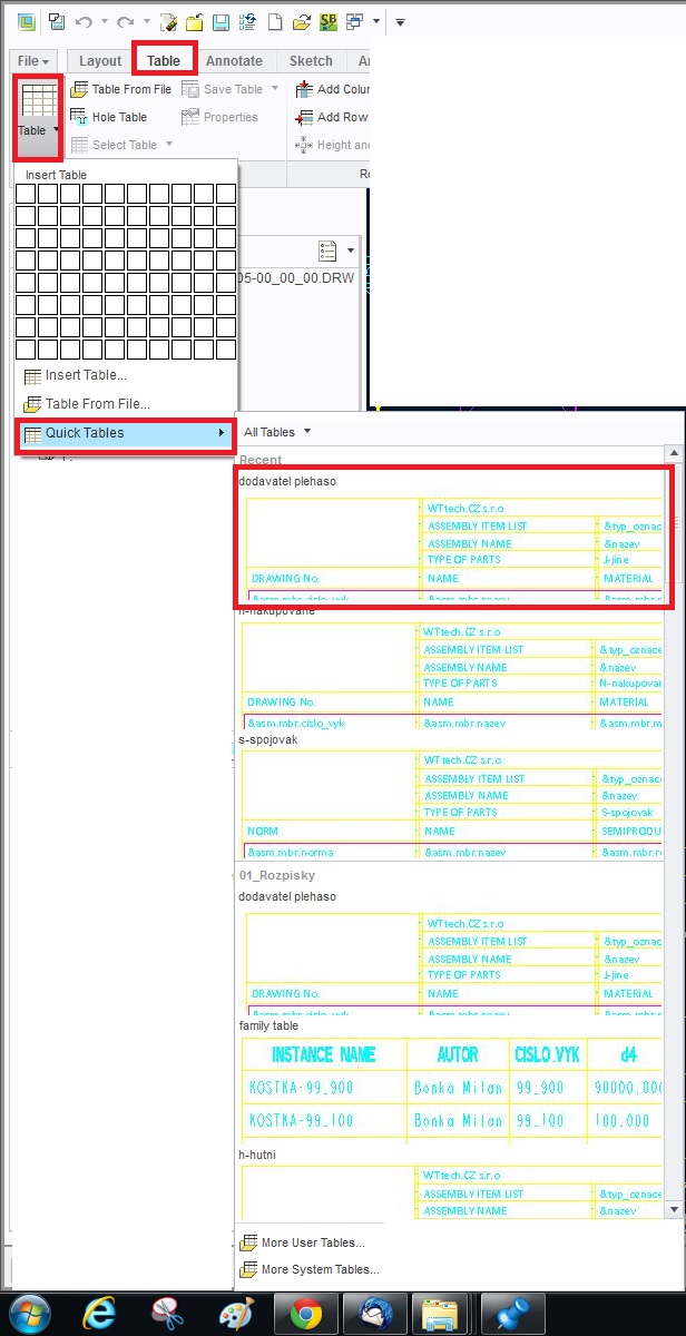

l prefer predefined BOM tables shared in our company ---> every user has same tables ---> set your pro_table_dir config option.
Key factor in my BOM tables is column filled with a star " * " between each two columns that l want to separate in Excel.
Reason why l use a star column:
1) If text in a cell is too long and goes to next column, you will have divide a name into two cells.
2) Star is a prohibitted sign in Creo parameters name and etc. ---> don´t have to care about bad separating
l use BOM tables like following:
- create assembly drawing
- insert predefined BOM table (use desired simplified representation in this table)
- select whole table ---> SAVE TABLE AS ---> *.TXT file
Open TXT in Excel:
- FILE - OPEN select desired *.TXT file
- use custom column separator " * "
- that´s all
Hope it can helps you...

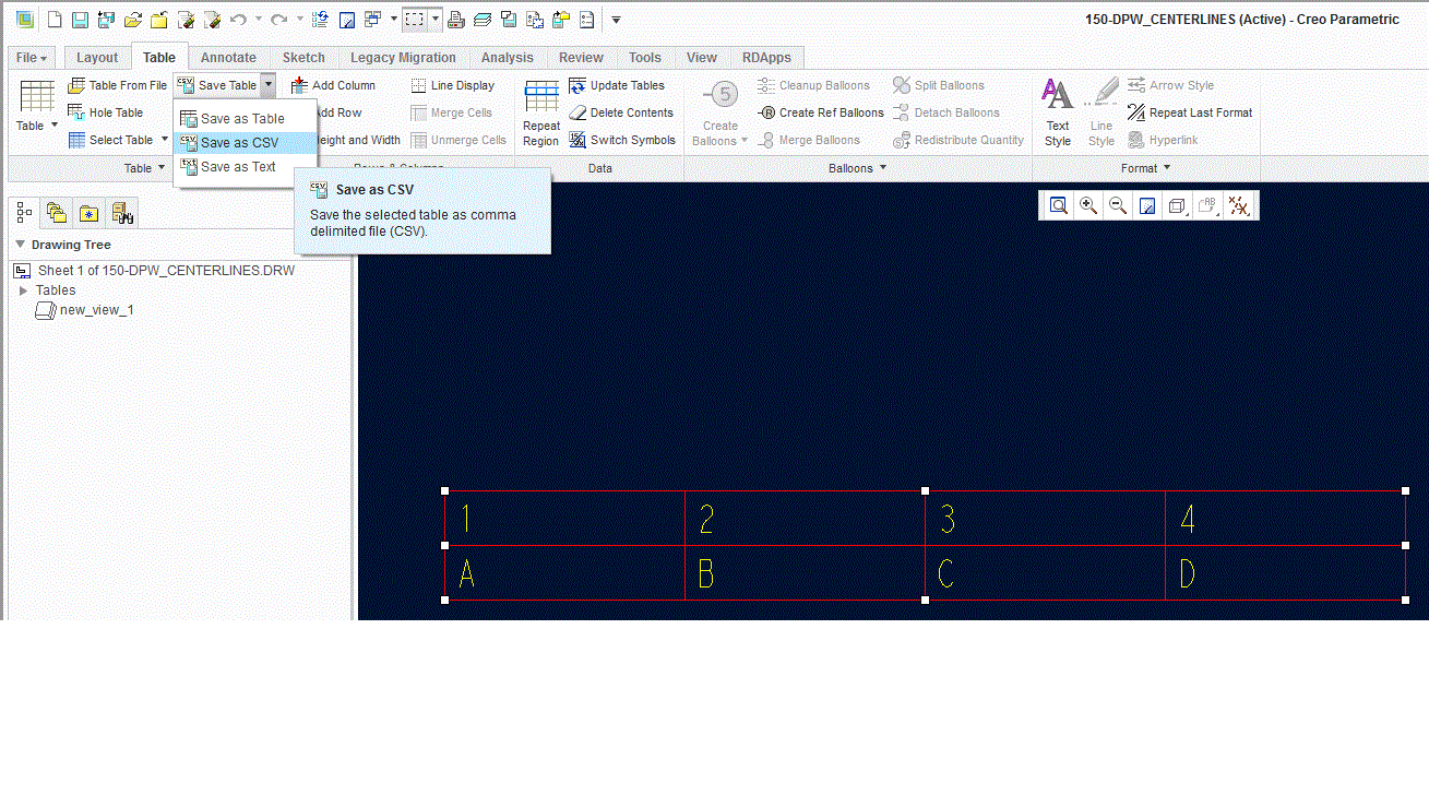

We have AAX (Advanced Assembly) license. It's not direct but there is a option to save table as CSV file. Once saved remove the version extension PTC adds, then file will open in Excel just fine.
Good Luck
Wayne
August 16, 2015
Additional info:To be able to save table as CSV file, user has to create a drawing with repeat region.
August 17, 2015
FYI, I am using Creo 2.0 M170, I am able to export a table as a CSV file WITHOUT it being a repeat region.CSV_Table.gif
