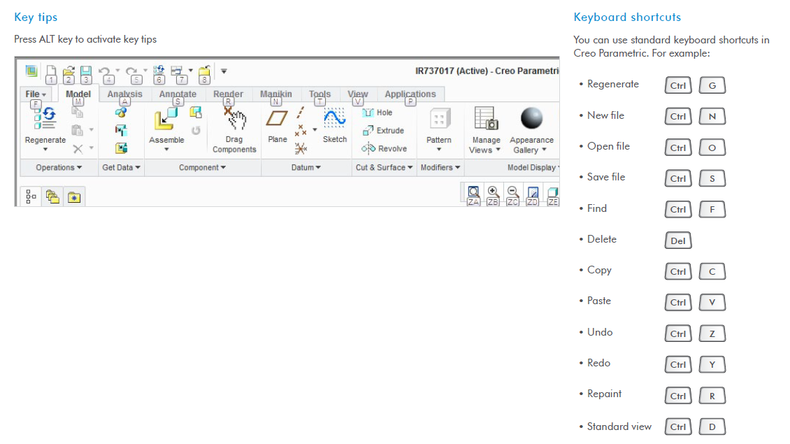

There appears to be a lack of documentation on keyboard accelerators (hotkeys) for Creo 3.0. I scoured the help documentation and even opened a case with PTC. Neither one could provide anything. Here are the accelerators I have located so far. Please let me know if you find other ones. Thanks.
AcceleratorNameDescription
Ctrl+KHyperlinkAdd, edit, or remove a hyperlink to the selected text.
Ctrl+GRegenerateRegenerate the model. In drawing mode also redraws all views.
Ctrl+FFindSearch for, filter, and select items in the model by rules.
Ctrl+AActivateActivate this window. (Should not be necessary in Creo 3 - windows are supposed to automatically activate.)
Ctrl+NNewCreate a new model
Ctrl+OOpenOpen an existing model.
Ctrl+SSaveSave the opened model.
Ctrl+PPrintPrint the active object.
Ctrl+ZUndo
Undo the last action. (Only valid for certain actions.)
Ctrl+YRedoRedo the last action. (Only possible if undo was used. Not "repeat".)
Ctrl+CCopyCopy
Ctrl+VPastePaste (Not the same as "paste special".)

Ctrl+D :- for standard orientation or default orientation
F10 ot Al t:- to activate shortcut keys for all options..only from pro/e 5.0(drawing) and all the options in creo 1.0 onwards

Ctrl+F1 :- to hide the ribbon.

Since I can't edit the original post, I have converted it to a document. You can find the current version here: http://communities.ptc.com/docs/DOC-6271
