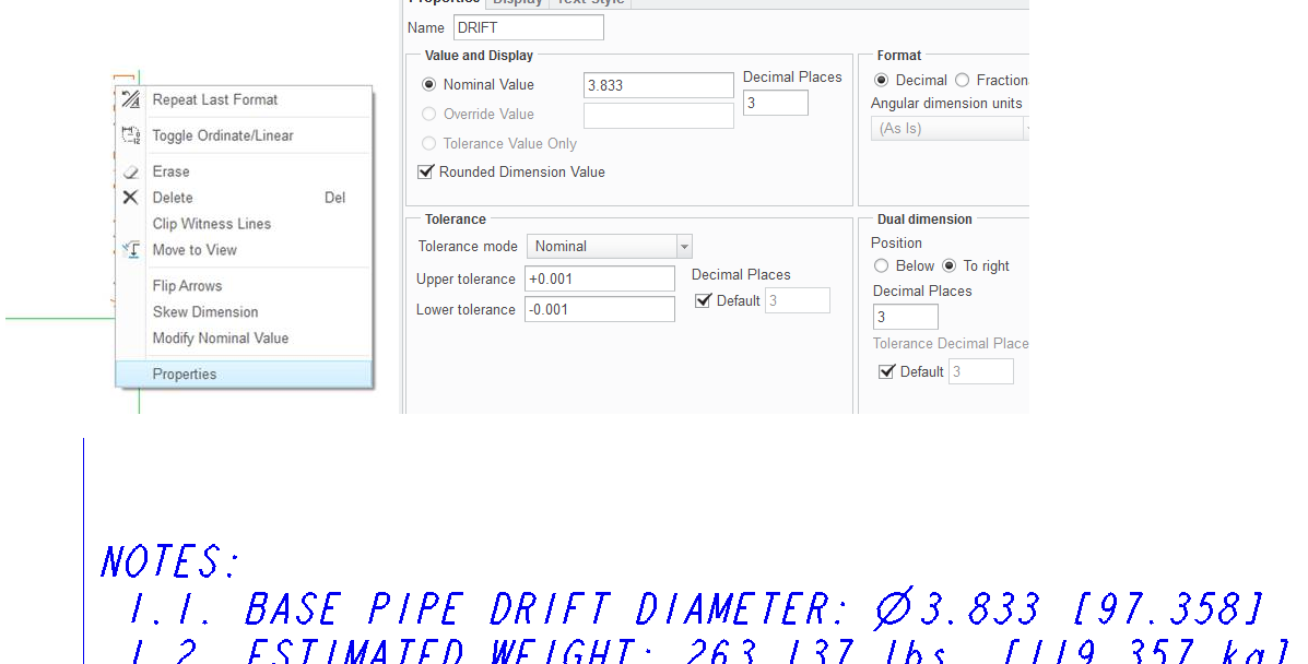

Hi there, we must be missing something - it appears Creo 3 doesn't allow editing for dual dimension properties - eg: show them below or right?
In Creo 2, you can select the dimension, then right-click - Properties and adjust there - but Creo 3 has no option for this?
Nothing shows in PTC help search.
Thanks for any guidance.

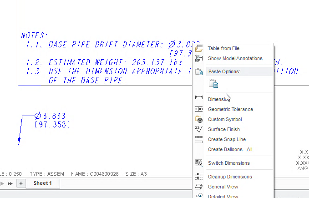

Hey folks, I have a workaround for now, though hoping there's a "proper" way to do this...
Remove the dimension from the note, then right-click Properties on it, set below, then add to note again...
Edwin
