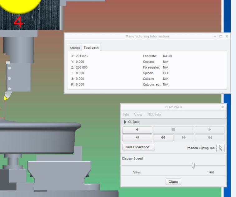

Thank you PTC for finally fixing two features that have been a pain to use , since the launch of Wildfire 5.0
1. the manufacturing information window, is now staying on top, and not going behind every time you do something, so annoying and difficult to use, now its fixed. see image:

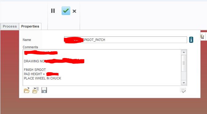

2. The operation comments window size is now fixed, I can now see what I am typing, it had been a very small window that couldn't be resized, like looking through a hole in the fence. now it is fixed.see image
